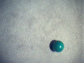

Source ImageGreen Filter with 10, 30 threshold
