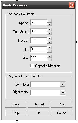

I was wondering if there is anymore information on the Route Recorder module?  It is in RoboRealm but there is no explanation or anything about how to use the module on the documentation page.
Thank you very much,
-Ben

No. I am talking about the Route Recorder module.
A picture of the module is attached.
Ben,
that's an alpha module (not yet released) that is in the RR download for specific clients to test. As it is not released yet no documentation nor official release has been done for this yet. I'd recommend EDV's advice and have a look at the AVM module which contains a similar technique to the route recorder.
