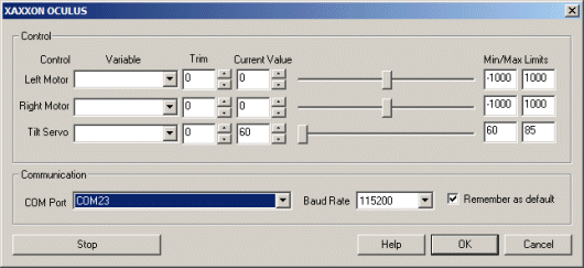

1. COM Port - Specify the COM port that the ArduinOculus is connected to. Note that the ArduinOculus comes with a USB cable that simulates a serial port on your PC. The port number for these kinds of virtual ports are normally above the standard 1-4 physical ports.
2. Baud Rate - Specify the baud rate of 115200 to communicate with the ArduinOculus. Note that this is much higher than the standard 9600 normally used. The higher rate provides much better responsiveness than the lower rates.
3. Remember As Default - Select the "Remember as Default" checkbox if you would like the current COM setting to be remembered by RoboRealm such that whenever the ArduinOculus module is loaded the COM port and buad rate will be auto-populated to the current setting. This ability allows you to not have to constantly change the COM port setting when loading in successive RoboRealm robofile configurations.
4. Motors/Servo - Once communications are specified you should be able to move the appropriate slider in order to see the motor move. If the motor does not move, check your USB connection and motor wiring.
5. Variables - Select the appropriate variables that contain or will contain the position value that will be sent to the motors. This is used to automatically change the motor values based on your VBScript (using the SetVariable function) or Plugin based program.
6. Current Value - To manually set the motor position type in the appropriate number (-1000-1000, 0 is the default neutral) into the text area or use the slider to adjust the value. The motor speed will be updated as appropriate.
7. Sliders - You should be able to move your motors by dragging the sliders to the right or left or by specifying a number within the current value text box. If the motors do not move check your USB cable and/or board power connections.
9. Min/Max Limits - You can also use the min/max limits to ensure that even if the variables specify large or low values (due to programming errors) that the board does not actually attempt to move the motors above or below the specified limits. This can be used as an additional precaution in case your motors cannot physically move beyond certain limits.
