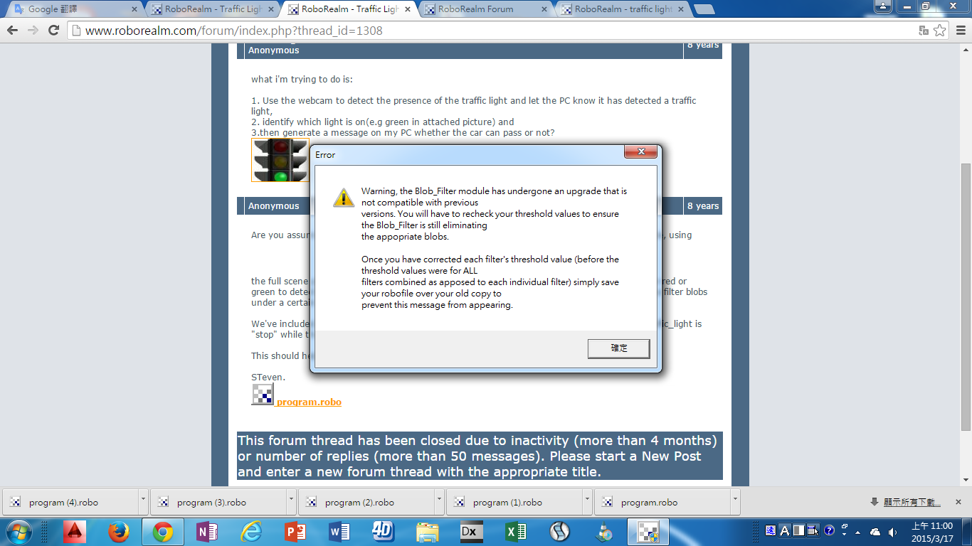

i want to use webcam to detect the green light, yellow light, red light and then give the signal "go" "prepare to go/stop" and "stop"
when i search other post which related about this detection as a reference.
such as this link http://www.roborealm.com/forum/index.php?thread_id=1308
it said that
how to fix it
thanks a lot

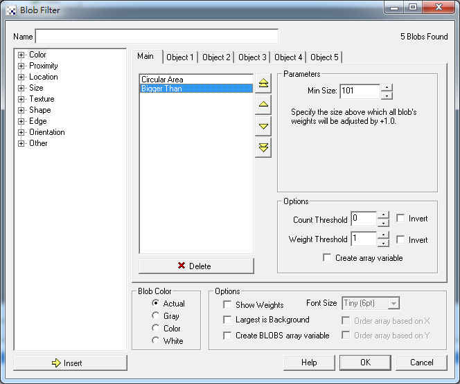

hi steve,

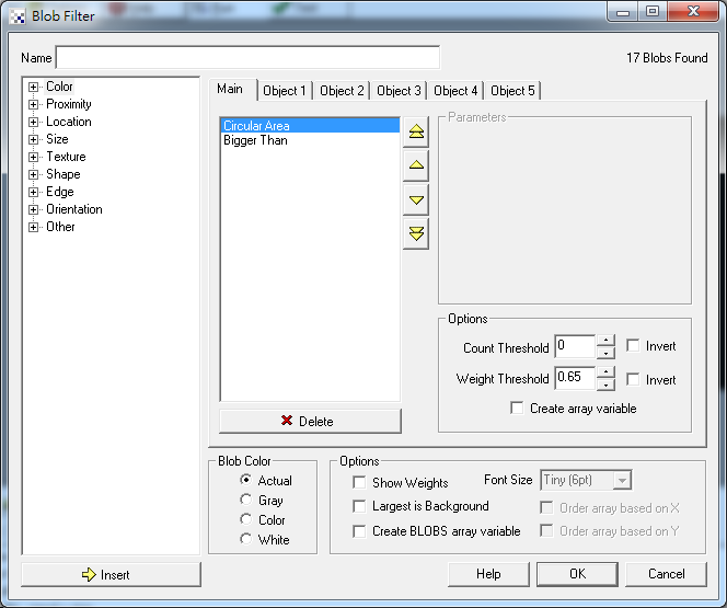

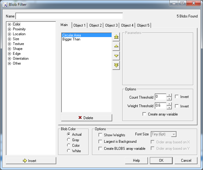

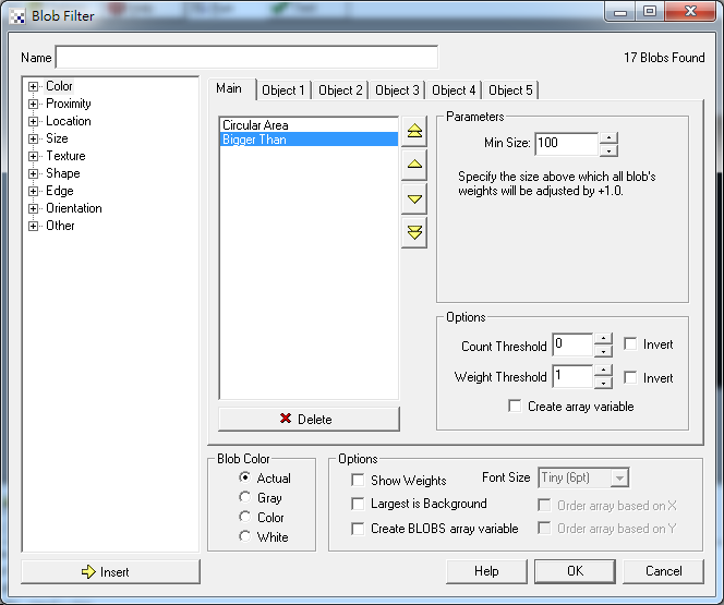

regarding the blob filter, i don't understand " circular area " & bigger than"'
in RGB filter RED
circular area : weight threshold is 0.6 "why is 0.6?"
bigger than : the min size is 101 " that means?" and the weight threshold is 1 ??
in RGB filter RED
circular area : weight threshold is 0.65 "why is 0.65?"
bigger than : the min size is 100 " that means?" and the weight threshold is 1 ??

David,
If you review the blob filter documentation at
http://www.roborealm.com/help/Blob_Filter.php
that should help explain what the value are. The actual values used just appeared to work for your images and are not necessarily directly related to a specific image. They were empirically determined by testing your images. This is why many more images are needed to ensure that the values are actually the right ranges.

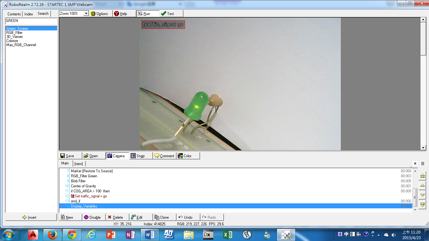

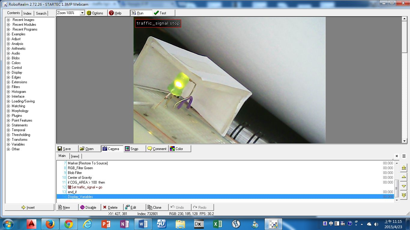

" real time to detect the light"
i means that use the camera to detect it because the method for detect the traffic light is a image before
for the below image is use the camera in real time but when i try to detect it is not focus the GREEN LED
Carl from Your Country [1447 posts] |
10 year
David,
I think we have a communication issue ... your description is very difficult to understand. What I think you are asking is how to just detect the GREEN LED? If so, then the LED is NOT round like a traffic light and thus gets eliminated by the filter.
Instead, just click on NEW pipeline, add the RGB_Filter and select the green color checkbox [] Green.

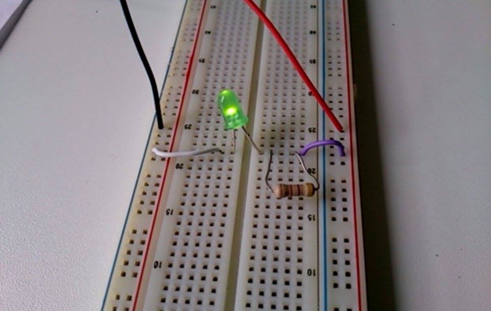

sorry for my poor communication. if i want to test the LED
show below in the upload file
between 2 picture, it can see that one of the picture is detect and give out the "go" signal.
it is the around lighting affect the detection?or other problem affect?
10 year
The trick to detecting LED's correctly is to switch you camera exposure to a really short time. Or set your shutter speed to very fast. This will make the entire image MUCH darker but you will still see JUST the LED in the image when it is turned on. That will make this much easier to process.
The problem is that the LED light is overexposing the camera's pixels and causing the 'green' light to appear white when it should just be green.
