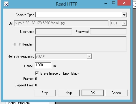

have an webserver (APACHE) with a jpg file.
When try to accses with Read HTTP Modul image is not read (keeps black). When accses the same url (copy/paste) with firefox everything is fine.
br,
Sascha

Carl from Your Country  [1447 posts] 10 year
Sascha,
There were no changes to that module between those versions. You can check the version log:
http://www.roborealm.com/downloads/version_log.php
What is most likely happening is that another module is causing the problem. Can you attach your robofile to this post? We'd like to see what other modules you have running that might be the cause of this error.
