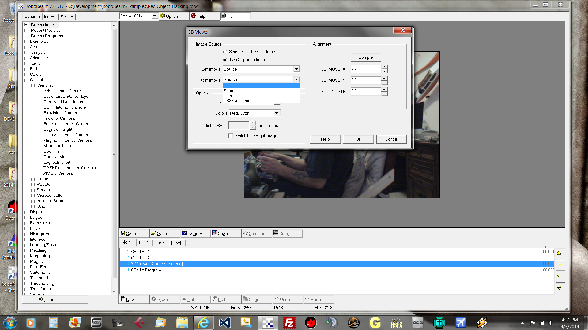

I have two CL_eye modules running in the pipeline.  I am using the Code_Laboratories_Eye modules successfully for the two cameras, each has a unique GUID.  When I try to use other "multi-camera" modules, they do not recognize that there are two separate CL_eye instances running and I can only select one camera in the drop down camera selections boxes ie. 'source' or 'current'. Is there any way to make the two cameras visible to these modules?

I realized from your screenshot that you are not using the CL_Eye module ... which you will need to use to access each camera. You can then set it to save the image as a marker which will then appear in other modules. Note that you would then use 2 of these modules to get each image.

Sorry, the CL_Eye modules were running in the Tab 2 and Tab 3 and I was using the call module to use them in the Main Tab, that is why you don't see them in the screen shot.
I didn't have the cameras set to save as marker.  That seems to have done the trick.  Thank you very much for your help and quick responses.
