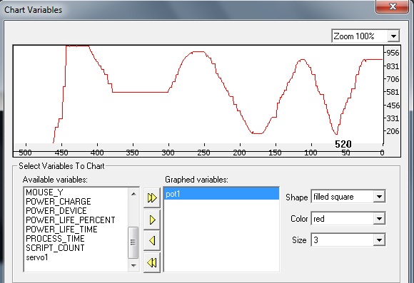

I'm trying to control a servo with a potentiometer, but as I turn the pot the servo will jerk every few degrees until it gets to its destination.
This only happens when I try and use the pot. If I control the servo via the modules slider or a joystick it works fine.
I have both the pot and the servo wired onto an Arduino Duemilanove to try and eliminate all the variables of what might be wrong, and have the robo file boiled down to bare basics (which I've included), and it's still doing it.
I've tried different servos, different boards (an SSC-32), different pots, and it always does it. Making me think I'm doing something wrong in Roborealm. But with only two basic modules left I'm not sure what it could be...

Have you tried graphing the port1 variable using the Chart_Variable to see if that input also has noise on it?
http://www.roborealm.com/help/Chart_Variables.php
This is most likely the cause since AD conversion has a lot of sensitivity and can have a good deal of noise. If that is the case you may try using
http://www.roborealm.com/help/Filter_Variables.php
to smooth port1 and see if that helps.
This appears to be a common issue ... see
http://forum.bildr.org/viewtopic.php?f=20&t=74
for starters.

When I chart out the variable I can see what I assume is noise, as it corresponds directly to the jerks in the servo movement. I've included a picture of it, just to make sure I'm not reading it wrong.
I've been playing around with the filter module but haven't figured out how to filter the noise out with it. But being I know where to start I can play with it now.
Also going to try a low-pass filter if I can't figure out the filtering module, thank you for that link.
