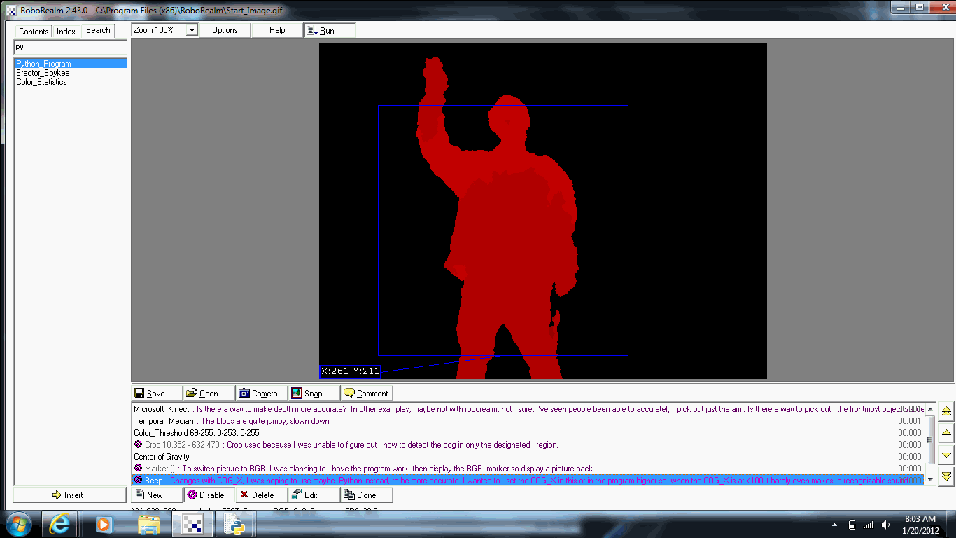

What I would like to do in the future is possible make, using the Microsoft Kinect, a sound playing device just be depth sensing a Roborealm. I am currently just conquering the big step of being able to set up the ability to detect the body, or possible better, a body part, that as it moves, to hit different key frequencies, not like a slide whistle, but possible implement a keyboard idea and develop farther from there.
Cropping: Is there a better way I can only take the COG from a designated region?
Python: When I would try to use the GetVariable function in Python ""cogX = GetVariable("COG_X")"", I get a ""name 'GetVariable' is not defined
I only have a slight knowledge in Python, not even sure about the other programs.
Exporting Text: Trying many different tactics to get the program to work, I tried just export the COG's coordinates to a .txt file then just using a Python program there, but I could not get the program to work due to my lack of skill
Here is my error filled attempt at that

If there is any way I could be using the Kinect better, please let me know.
I have also made some comments on each of my steps.
Paul,
Cropping: Yes, see the Crop module
http://www.roborealm.com/help/Crop.php
Note that you can use something like
[COG_X-10]
[COG_X+10]
[COG_Y-10]
[COG_Y+10]
in the start and end boxes (literal as typed above) as those fields are processed and interpreted [] signal it as an expression. See
http://www.roborealm.com/help/Expressions.php
Python: Try
cogX = rr.GetVariable("COG_X")
that's what that
import rr
is for. The rr object is needed to access all the internal RR functions.
Exporting Text: You could also try using the
If_statement
module to surround a
PlayWav
module and get that to work right in RR ...
Your external python script seems right assuming that newlines got added into the file.
