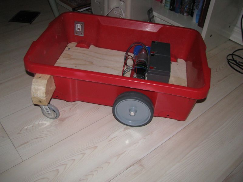

I just would like to know if roborealm is suited for my kind of project.
A year ago I tested to see if the trial software was able to detect a red box on my lawn and then also to see if the COG moved when moving the box a few centimeters. It sure did.
Now a year later the chassi and drive motors of the robot is in place and it is time to take the next steps and the question is really if roborealm would suit my needs?
The robot is controlled from a PC which I put on top of the chasssi. Commands are sent via my own visual C# SW to the motors via simple RS232. Now I would like to connect my PC with a camera , wireless  ofcourse,  so the robot could know its location. Somekind of wireless camera of course seeing the lawn with the robot from a higher position.
How would I best use roborealm to get a location? Can and should I run roborealm SW from within my C# SW ? How do I best make the connection from a IP-Camera->PC->my visual C# ?? If it can work I would gladly buy the SW for this hobby project.
thanks/Fredrik
