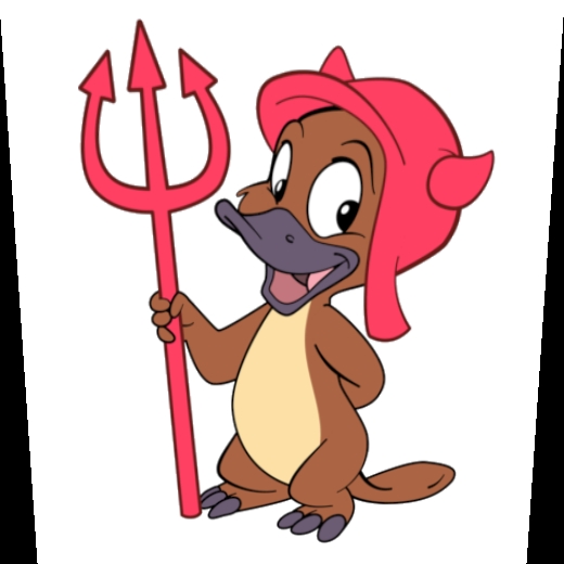

Yes. I need to perform Perspective Transformation on a bunch of images(as a batch process). I tried to do it manually using Perspective correction module under Transforms module, which worked for single image.
The input image is : [image1]
The output image is: [image2]
I need to automate the process by writing a .robo file (with tagged syntax) so as to perform the correction on all the images.
