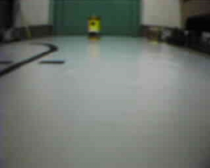

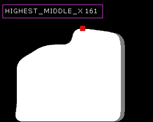

Ok,I have got the X as image1 and the information in VBscripe is in the image 2. But the robot did not move. Thank you.
Guo
Did you specify the right variables in the SRV GUI interface? I.e. try to track down if the variables left_motor and right_motor are getting created and then specify them in the motor dropdown menus for the SRV. Basically you need to tell the robot what values to react to.
