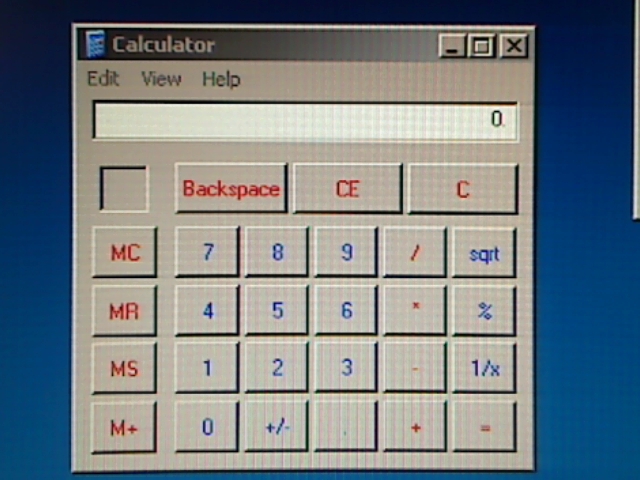

I tried a couple cameras and the best one we have seems to be the Logitech Orbit/Shpere AF as it certainly has very good optics but also allows programatic control over the focus and zoom which you can use to get reasonable images. I didn't think it would be so difficult to get a nice image from an LCD screen (never tried this before) and it does appear to be quite a challenge.
Attached below is a sample of a *very* small portion of the screen but with enough resolution that one could perhaps do OCR on. Screen was about 6 inches away from the camera.
The second one is the same image but slightly out of focus ... this helps to eliminate the grid like response from the CCD's of the LCD's but at a loss of detail.
If anyone else has better results please post the images here!

Is there a specific reason why you elected to "see" such a small portion of the screen? Would seeing the whole screen overload speed or space requirements?
Sam,
Yes, I was trying to get large enough text such that you could potentially run an OCR on it ... not that you wanted to do this but I figured that it would illustrate that this is possible. If the entire screen is captured then most of the text is way too small (probably the mouse too) considering that most webcams just do not have the resolution to capture such a large image with such high resolution. But this will depend on what you are trying to do as you could resize the screen to a lower resolution to help a little if capturing the entire screen.
