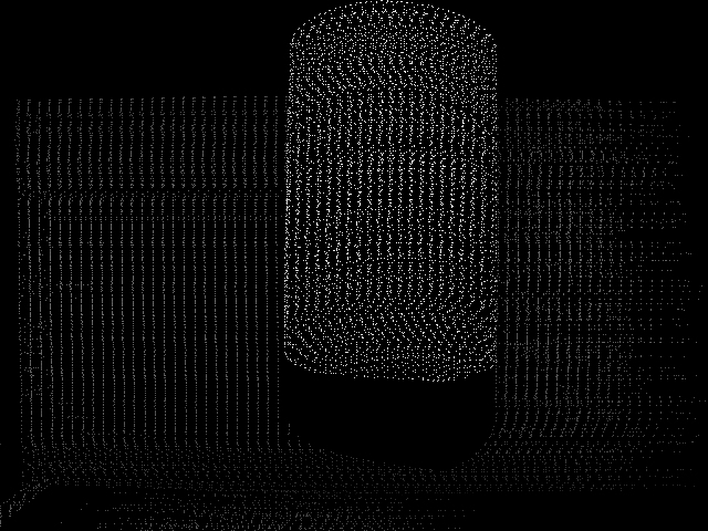

Here are the data points for a roll being scanned. The txt file contains 3 columns of data. By plotting it on 3 axis you can see the 3D details. The .fig is a MATLAB file of the 3D point cloud.

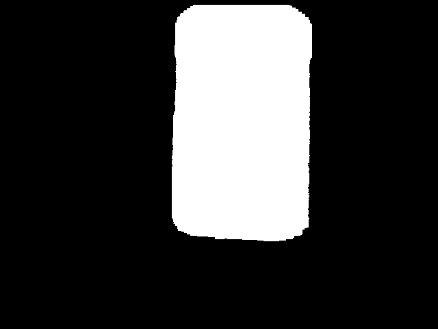

Ok, we got an image from that point file. The first is just a literal point image to see what we're working with .. which show objects quite nicely.

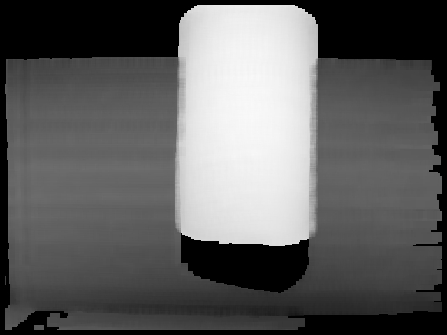

The second is a mean filter on non-zero pixels that helps to fill the empty spaces between the points without causing too much bleeding of the image edges. (more research can be done here ... but many standard techniques exist).
and the final image is what image2 looks like just using the auto-threshold routine to segment the object from the background.
Is this the kind of thing that you are interested in? We wanted to confirm with you that our thinking is along the lines of what you are thinking. Note that once the image is in the pixel domain many of the RR functions that act like cloud analysis such as the thresholding or flood filling routines should work quite nicely.

It sounds like you've got done exactly what I was asking about. I would like to be able to identify separate 3D objects, e.g. like blobs in 3D... The removal of background, you did, is awesome.
