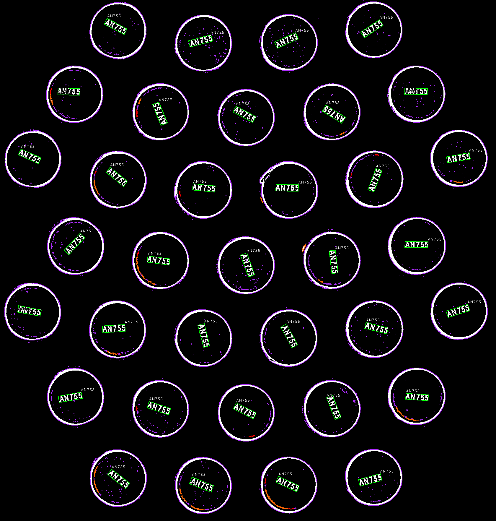

OCR module just underwent an upgrade to become rotationally invariant, i.e. it can read up-side-down text. If you download the latest version you should be able to run the attached robofile to get the results shown in the attached image.
Note, there are still some errors. Namely the 5 and S get confused since the characters are very similar. These errors can be dealt with depending on the nature of your application. If you know all the part numbers, then adding them into a word database and using that will further improve accuracy.
You will  need at least 10 more of these types of images to really test if the system is stable and reliable.
