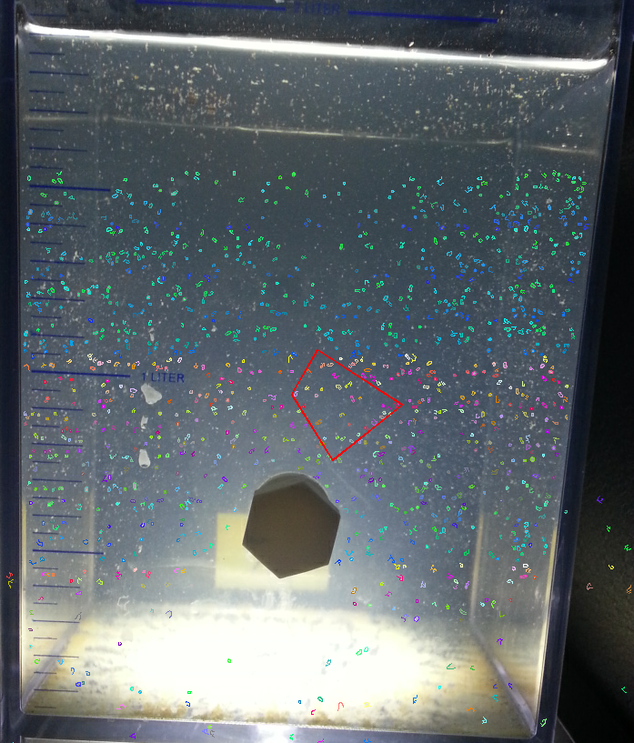

It is not actually a snow globe but it is the closest common example I can think of.  I understand the over lap issue.  But if we could count the different size blobs we could determine if there are too many large ones (>3mm) for example. I thought I saw an array of blob sizes, sometime reading before but didn't see that post again.  I am curious how one would quantify density other than counting then dividing by volume, if there is a function to do this this might solve the problem too.  The problemI am trying to solve is the see how fast the water clears .  Please refer to attached image  Thank you

What I would do is use the crop module  to just isolate a part of the image that contains particles, then an edge detection module that would detect edges and then a Color Stats module after that to check the intensity level of the edges. Less edges means less particles. You would do this for an image full of particles and one without and see the relative change in intensity created by the edge module. That's the measure of how many particles are in the image.
If you have an unannoated unmodified original image of both one with particles and one without we can provide you with the above steps for testing. Note, the image you included seems to have already been processed in some way so using that would not create the right results.
Checking the amount of edginess in the image doesn't require knowing the actual particle count ... which isn't needed when you are comparing relative images. That makes it a much easier problem that actually counting the number of particles in the image. Instead we count the number of pixels and divide by the area which is how the average intensity value is calculated. A single pixels doesn't equate to a single particle but that's ok for comparison.
