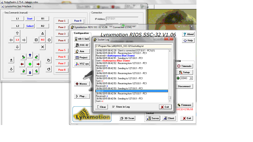

What do you see in the log? I get
Receeived: <buttonpress: Blue Down>
when pressing the blue arrow buttons. Do you get the same in the log?
Note, your firewall needs to allow communication from RR to RIOS.
Jean-Baptiste  [3 posts] 11 year
I see the same thing in the log
Please watch the picture attached.
Thank you
Carl from Your Country  [1447 posts] 11 year
Jean,
Can you download the most recent version of RR and give that a try? We found a potential issue in how RIOS was handing a terminating zero from the command sent. This has been addressed in the latest version.
