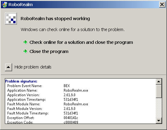

Same old Logitech QuickCam Pro 9000.  The only prompt offers me the choice of how I want to fail.  I can "Check online for a solution..." or just close.  The attached JPG file shows the beginning of the detailed log, but it doesn't look like anything you would write.

The log image you attached does help a little but its error location doesn't seem to make much sense.

I directly ran the the actual RR executable, not the shortcuts, as administrator.  RR crashed, but still no crash report.  :(
Windows crash dialog image is attached.
