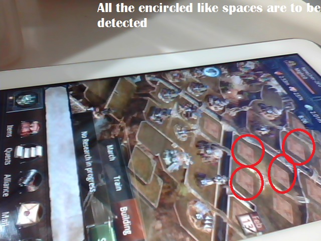

hi, i want to play game on samsung tab using roborealm. for that i need to detect the given game-blocks from camera. attached are the images ..
then i will create blob then find out co-ordinated and ask my Lego robot to click on the specified location .. Thanks

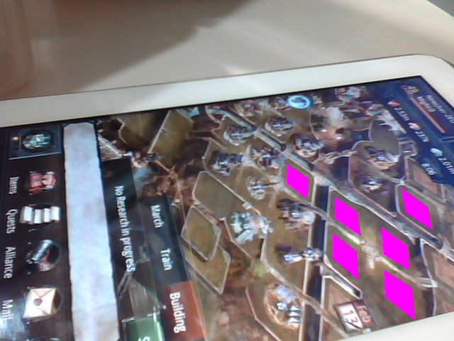

Something like the following?
Note, 1 image doesn't do it .. the robofile below will work for this image and break immediately for just about any other image. You'll need at least 20 to test with.
Any chance you can get a better angle like straight down on the tablet?
