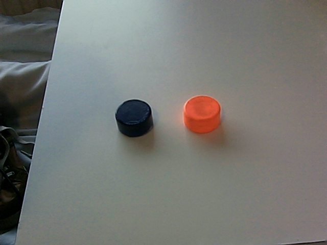

I would also not expect that you would want to use image recognition since your second puck is a nice orange color. Use the marker module to restore the image from the black recognition and use the RGB_Filter module to find that one.
