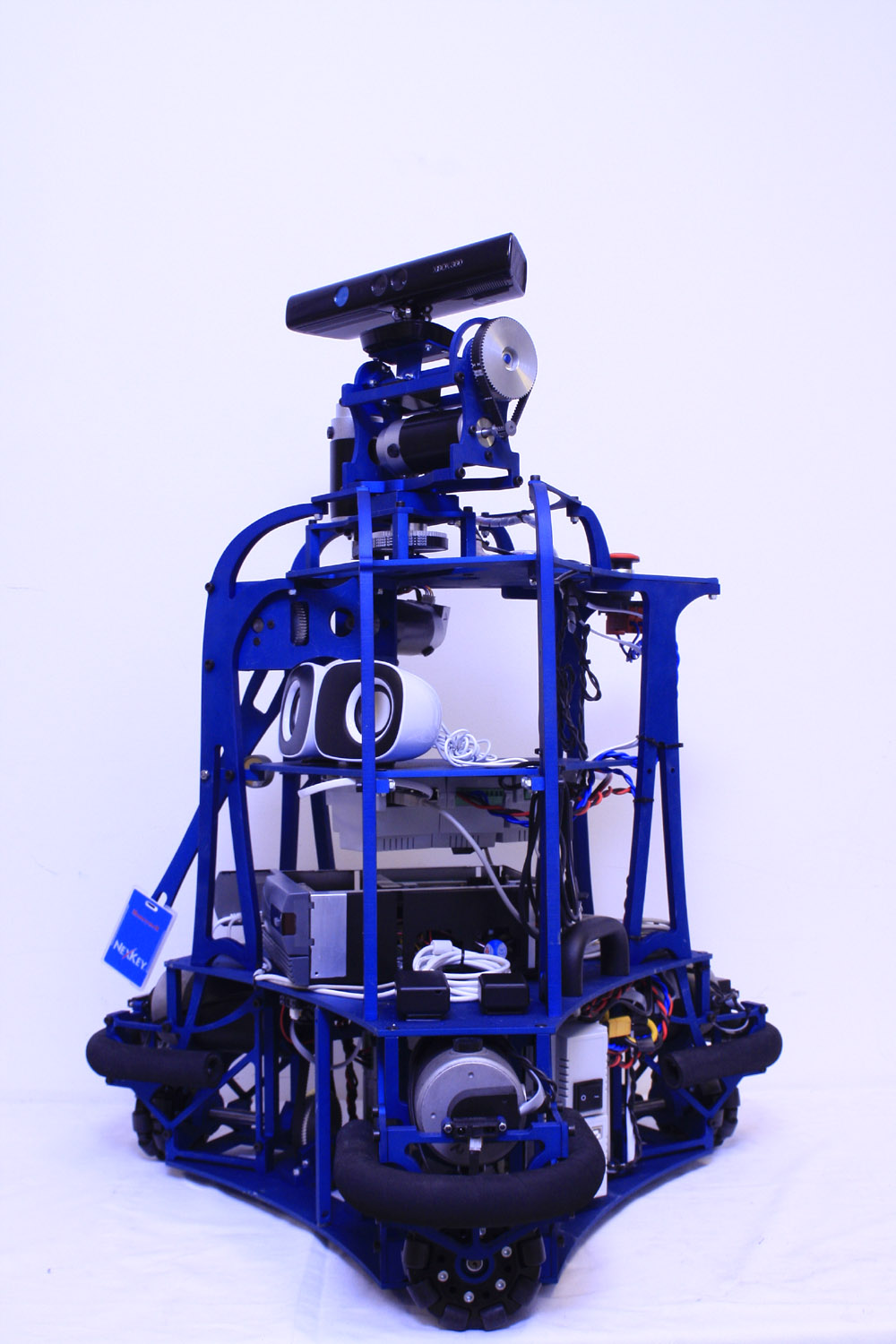

PS: I have attached a picture of the robot

That's quite a robot! You even put bumpers on it! Very cool.
