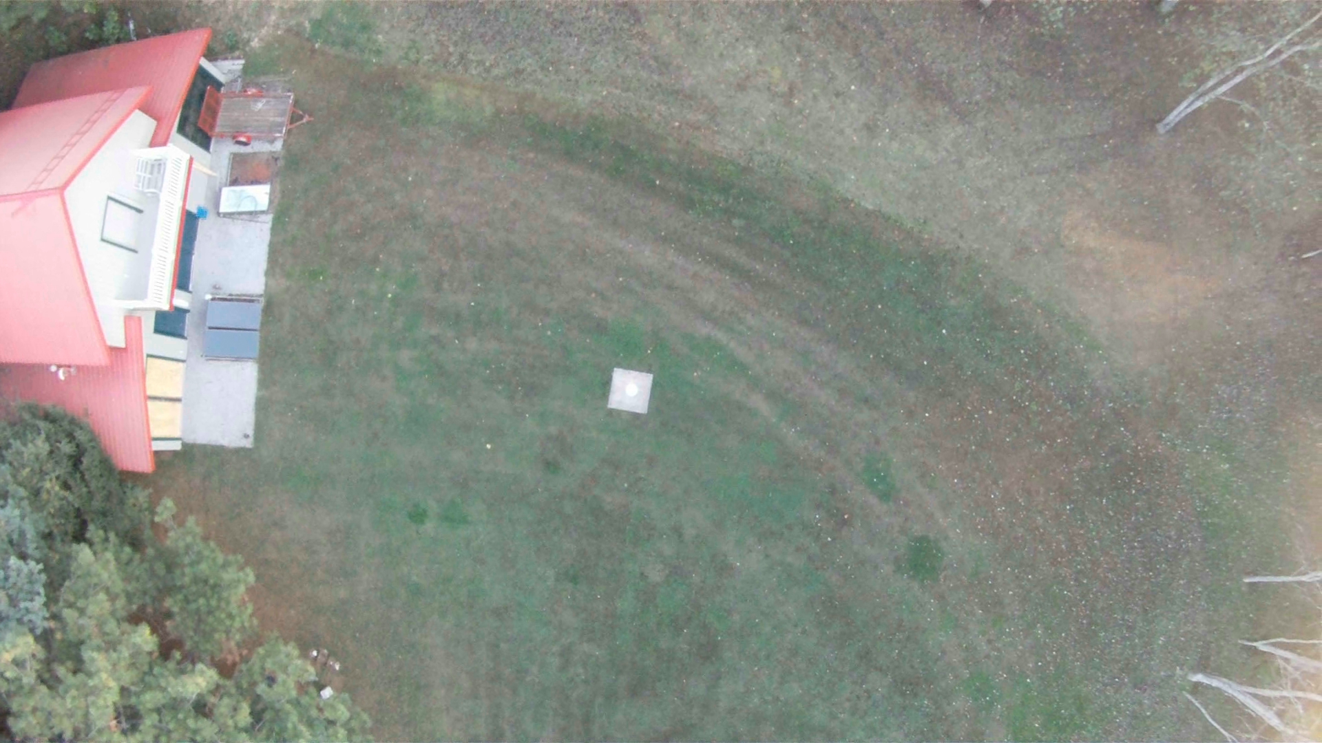

Just getting started in computer vision this week. I have had some successes and some failures. This is one that I cannot get to work. I have the camera mounted on a model aircraft looking straight down. I am trying to detect and track a rectangular shape on the ground as seen near the center of the attached photo which is a snap from the video. Using a gopro for camera. Once I am able to track it I will use the COG coords to guide the copter to the pad. How can I isolate the rectangular.

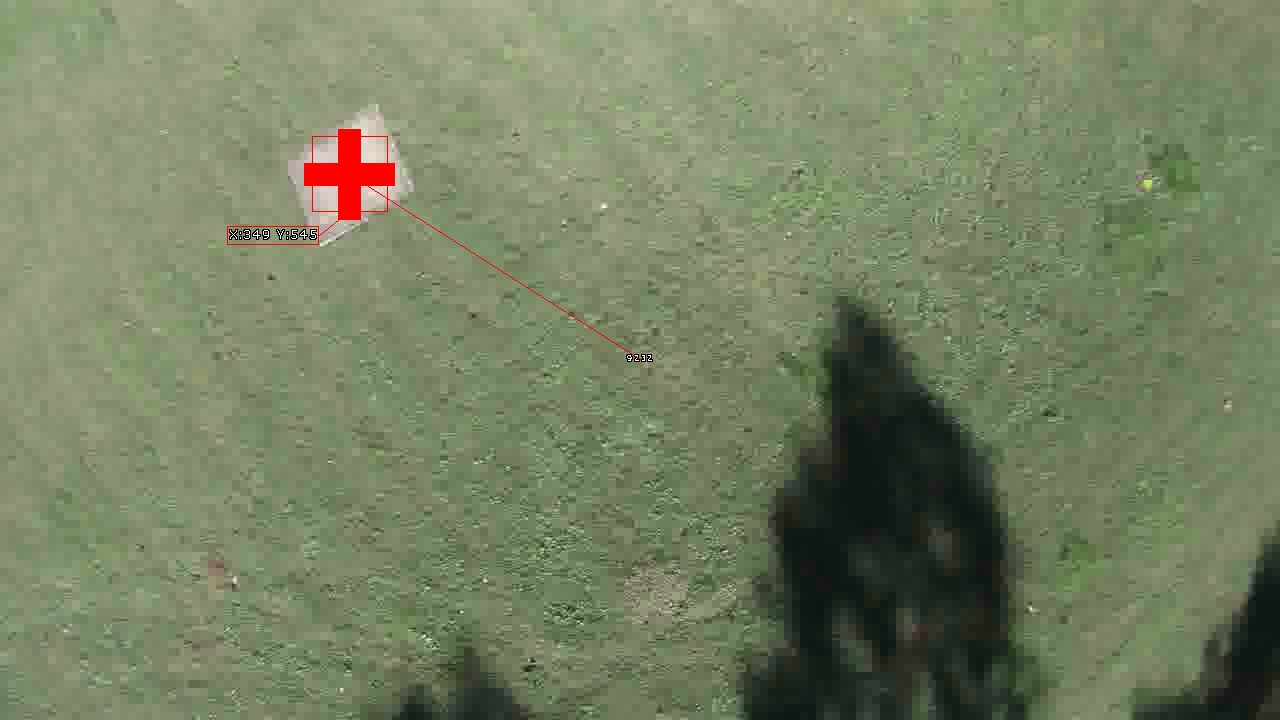

Some more info on my previous post. I have been able to isolate the rectangular landing pad in a previous video that did not have the nearby buildings and the altitude of the copter was lower.(see attached image) and I passed the COG coords to VB thru the clipboard. However in the latest video with nearby objects and buildings I am not able to identify the rectangular landing pad.

the attached works (after you download the most recent RR version) on the image that you provided first. However, are you able to post a movie somewhere? Using just one frame to verify a technique is not a good idea as it will most likely be too brittle to work in general.
The basic idea is to look for something relatively white, relatively large, relatively isolated from other white things ('further than' attribute) and relatively square. We first isolate potential objects using the adaptive threshold and try to filter the image for invalid stuff to just leave the valid square.

Yea, getting the video from youtube worked well. I've attached a new robofile that fixes a bunch of problems that occur within the video. There are still one or two cliches but the general stability of the target detection is good.
You will have to download the latest version of RR and also change the first line of the robofile to your video.
You'll need to take a couple more videos just to be sure that things are tested to a basic level of confidence ... but the basic idea seems to work.
Note that a fundamental attribute is that the landing pad is not placed near to any other white object ... so that's something to keep in mind.
