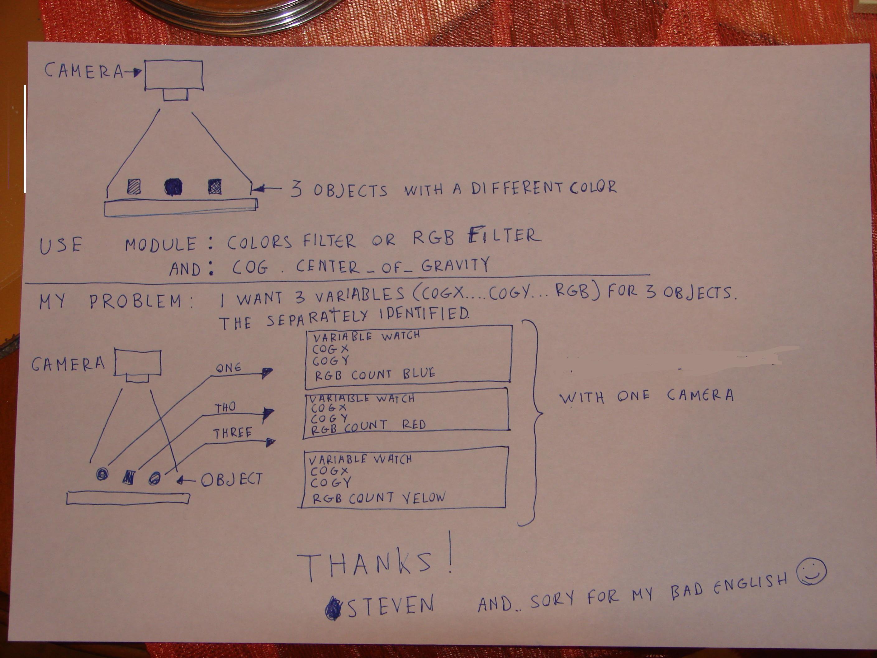

work with 3 different colors with variables
Carl from Your Country  [1447 posts] 12 year
Can you post the image you are talking about that the camera sees with the 3 colored objects?
athanasios from Greece  [4 posts] 12 year
thanks ! very much.for your fast help.

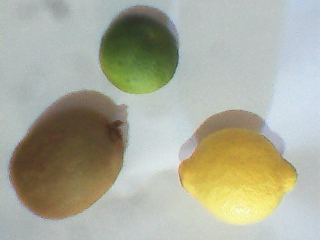

See attached. The BLOBS_COLORIZED_LABELS then contains the COG and color value of each blob. See
http://www.roborealm.com/help/Blob_Colorize.php
on what each value in the array means.
