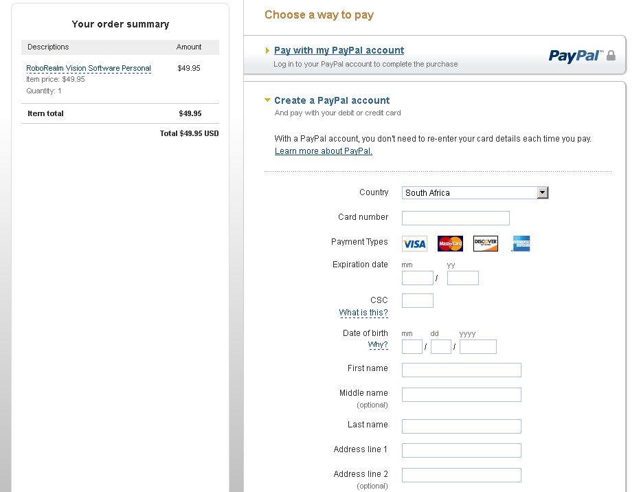

PS, I wanted to use my credit card, but see I still only have the Paypal option.
