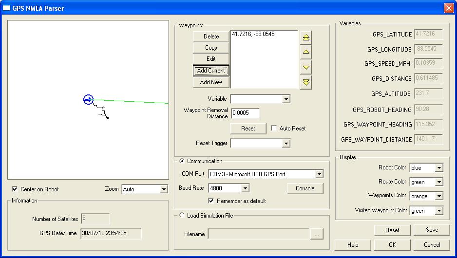

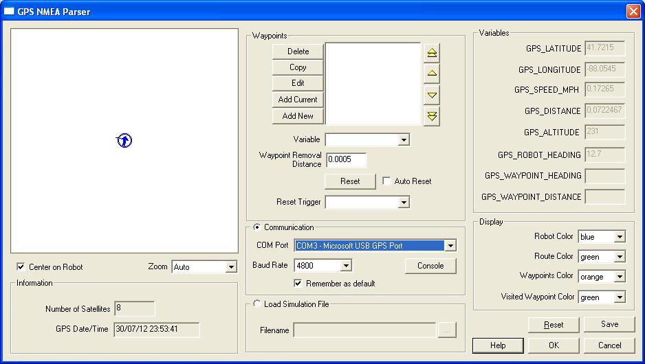

I'm using the GPS_Reader module and trying to set waypoints. When I add the first waypoint using my current position, the GPS_WAYPOINT_DISTANCE value is 14,000+.
Any thoughts on why the waypoint distance is so large? It appears to be ignoring the waypoint list.
