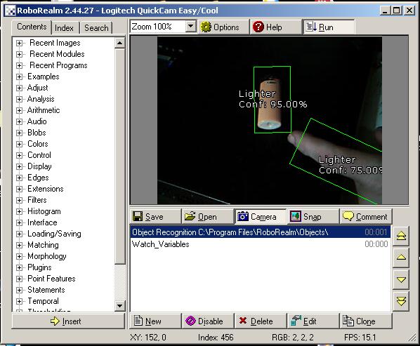

Any idea why the object recognition module would see a nonexistant object in an empty background space?  Here's a screenshot of what I'm talking about...
Carl,
Any chance you can post the original template and the image above without any annotations (i.e. the source image)? Also, what recognition method are you using? Feature points? Shape?
We can then check why you are getting that ghost image.

Sadly, I no longer have the original source image.  I was using Haar
recognition at the time, attached are the .haar file and the .robo file
of exactly what I was doing.  The background isn't filtered, I used a
black surface in order to try and keep things simple.  I'd been having
difficulty having it recognize it consistantly when rotating it on the
plane of the surface, I gather training is properly accomplished by
rotating the object into several positions and hitting "Add Object"
and specifying an identical name each time, although this appears
to result in multiple objects rather than a single object recognizable
across a full circle of rotation.  Originally I'd tried using Feature Points
recognition but RoboRealm began behaving strangely, claiming not
to be able to load the image and giving a gibberish in the error popup.
Once it started that I couldn't get it to behave until I uninstalled and
reinstalled RoboRealm, then I switched to Harr recognition. I notice
now when I open RoboRealm the path looks strange as displayed,
looks like "œyirogram F¨yi\Objects\" rather than the actual path.
Thanks for your prompt attention,
Carl

Carl from United States  [18 posts] 13 year
Steven,
Thanks, it's much more consistant across the rotation even with only
a single train, although the bounding box varies considerably.  It still
produces the ghost at times though.  And another issue I forgot to
mention is that the OBJECT_ORIENTATION variable doesn't update,
remaining at some arbitrary value.  I've supplied the files for this
test, including the source image this time.
Thanks again :)
Carl
Objects.zip
Although it does misidentify, possibly since my methodology
is simplistic at this point.  I don't think my finger looks that
much like a lighter :)

It doesn't but that's why the system rates it as 75% with the ghost image being 70% and both lighter images being above 95%. So if you adjust the min threshold to 80 or 90 that will eliminate those matches. It is set to the default 70 right now which is lower than it needs to be just to ensure that something matches initially.
When adjusting that turn off tracking since that has an even lower threshold of 50 otherwise the bad matches will remain.
Give that a try and see if that helps.
