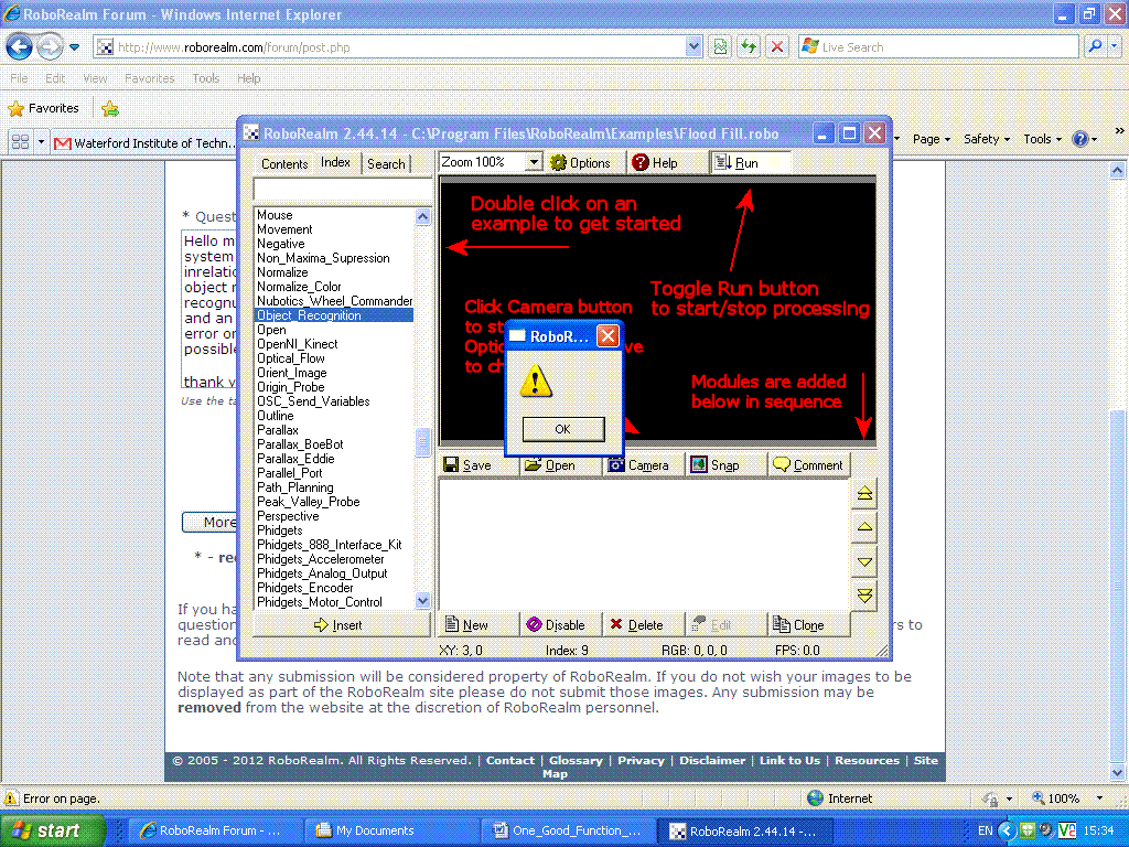

Hello my name is Vincent Murphy and I am using this software for a vision system in a robot for a college project.why i am posting this today is inrelation is the newest version of the software has some issue with the object recognition module. every time i want to incert the object recognuition into the pipe line a pop up comes up with a yellow triangle and an ! inside the triangle there is no text so i can not tell you what the error or warning is. i hope that you might be able to fix this as soon as possible.

please see the warning prompt in the image
Vincent,
We're not sure where that message would be generated from. What happens after you press the Ok button? Does the application exit? Or do you just not get the OR module inserted?
We updated the system to ensure that something would get printed to help us understand if this is a RR generated message or something that Windows is doing.
If the application does not exit after pressing Ok then please download the latest version again which should include some text.
Vincent from Ireland  [2 posts] 13 year
what happened when I clicked on the OR module was the prompt would come up I would press ok and the OR module would not start. every other module was working fine.
but
now i have downloaded the new version and i don't get the prompt and the OR is working. thank you so much for the reply and updating the software.
