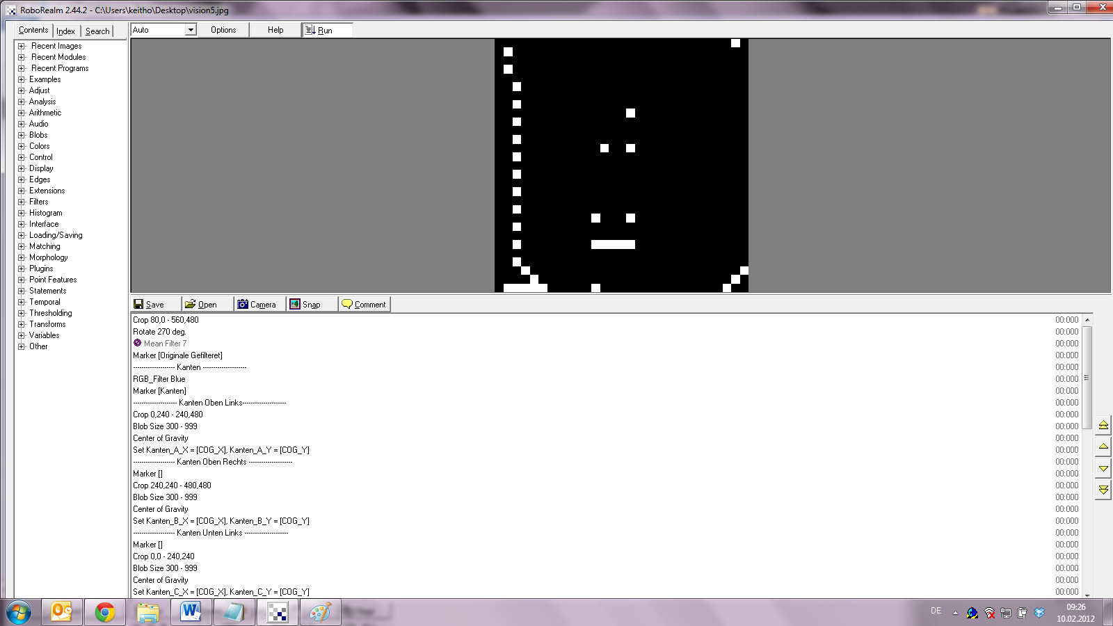

Bellow is a screen shot of my program. the dots on the 30th pix line is missing.
I think it might just be a display error
this is the screen shot from the program that you send me. on  my pc if one were to count the pix its 29pix in the Y axis
But the data is correct, it must be just a display error
i will try to reload RR
STeven
Yea, most likely just a display error. I'd not worry about it if the data and CTRL-C show 30.
