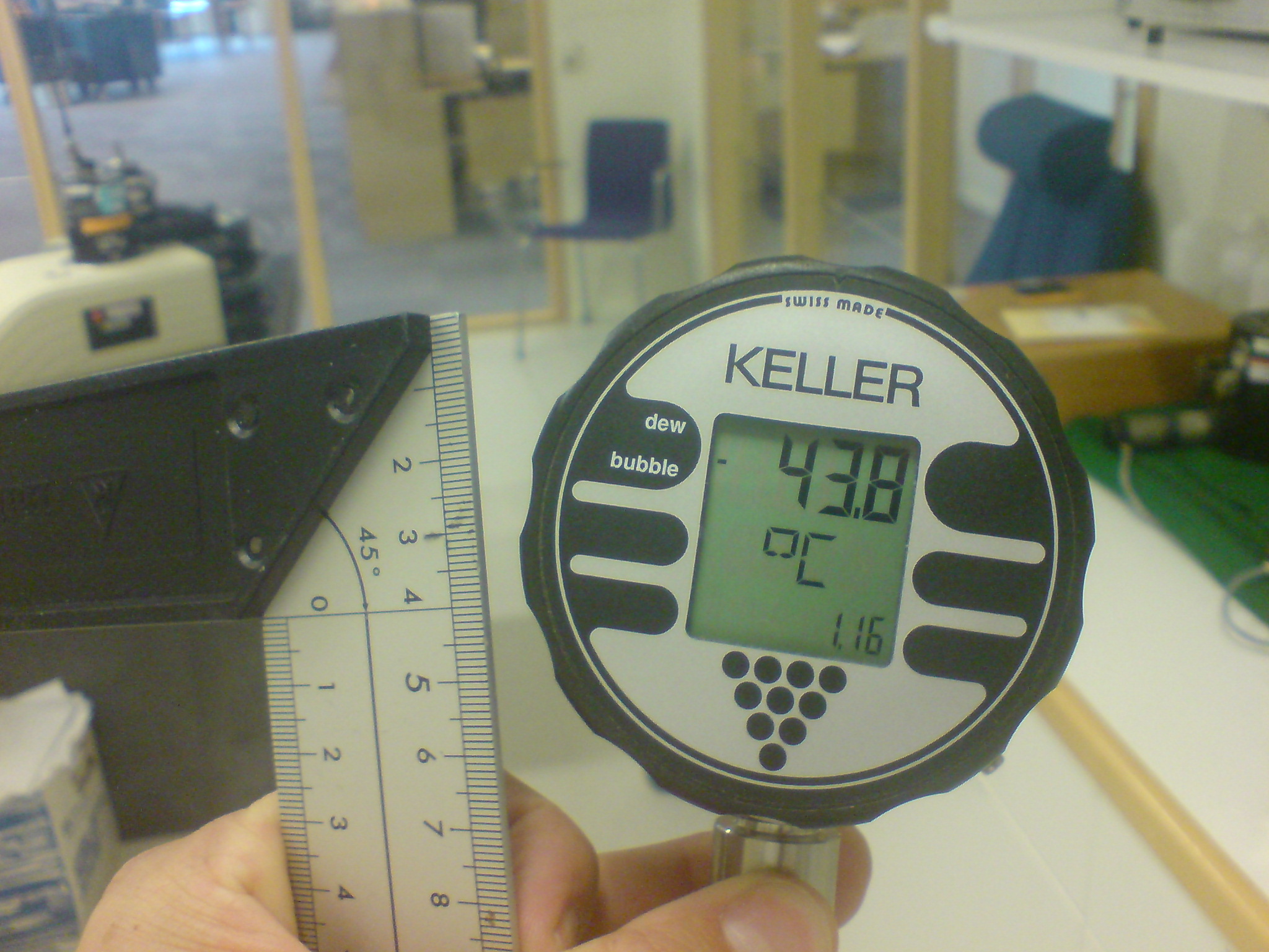

I tried the sample project for Digital Displays. I'm interested in using this but I could not make it to work. I tested with a display and a few objects to match. No luck. It does not match the numbers/files.
I tried to select the Digital display and then used the two other files to recognize the numbers. No luck. Can you give me a hint?

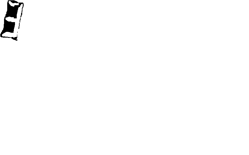

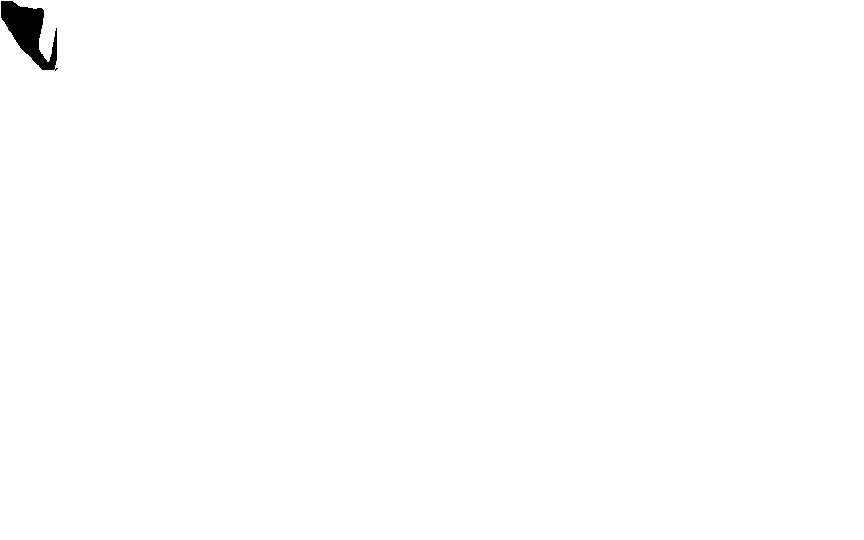

Seems that this one required some help in improving the contrast between the numbers and the green background. Its very important to have these separated correctly otherwise the digits will not be correctly extracted.
Attached is a zip file with the robo file and templates used to match the image you provided.
Note that its quite a large image so perhaps reducing the resolution will help speed up the process.
