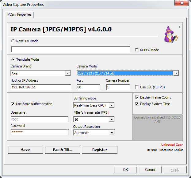

I wasn't using the Read_HTTP module, I was attempting to select and configure video from the IP Camera in the options dialog (screenshot attached to resolve any confusion).
After reading your post I tried using the Read_HTTP module, and it seems to work fine for what I want. I don't really need automatic pan and tilt, and existing functionality is fine for my needs.
