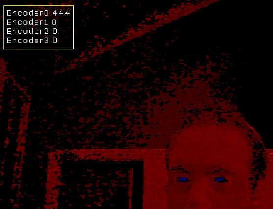

Ariel Sandez from Argentina  [3 posts] 15 year
Hi William,
                  To read remote phidgets I created the following simple rest service:
Singleton   - Phidget Encoder (java): Connect directly to the encoder.
Httpserver – Waits for GET request from RR, using the singleton read the
                   encoder position,
  Compose the response as following:
      <Encoder0>40</Encoder0>
      <Encoder1>159</Encoder1>
      <Encoder2>159</Encoder2>
      <Encoder3>10</Encoder3>
RR HTTP Module – Request every second the encoder’s value.
