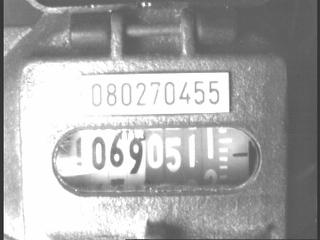

Please find me a solution to alter the black digits into white color.
This is necessary for the "shape_match" module.
With that i can then identify the digits.
Thx in advance.

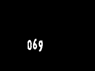

thx for the file, but i formulated my question not well.
I want all the digits from the original picture in white numbers with a black background.
I managed to get your result too, but i don't know how to get all the numbers in white color. ( = 069 0511)
Sorry for my wrong question.
Greetz
Anonymous |
It always helps to be as specific as possible.
See attached robofile.
