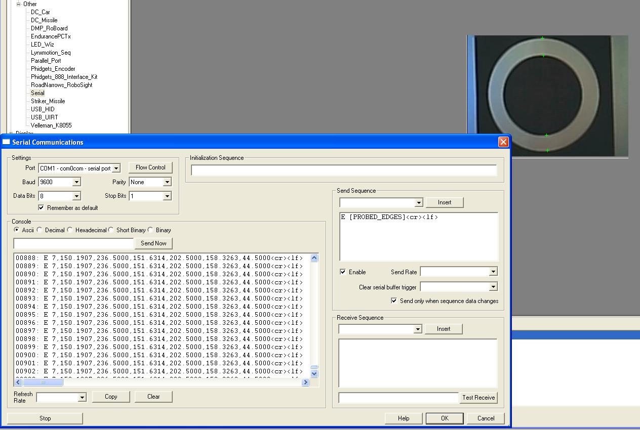

I'm using the Edge probe module, and then trying to send the found edges through the Serial module.  I've configured the module to detect 4 edges.  Whenever I insert the [PROBED_EDGES] array variable though, it only sends 3 of the found edges - see attached screenshot.
Mark,
This has been fixed. Can you try and download 2.24.13 and see if this helps your situation.
It seems that there we two problems. The first number should be the count of how many numbers will be transmitted. In your case that is 7 but should be 8. The second issue is what you noticed in that not enough points where being sent. Both of these should be resolved in the current version.
