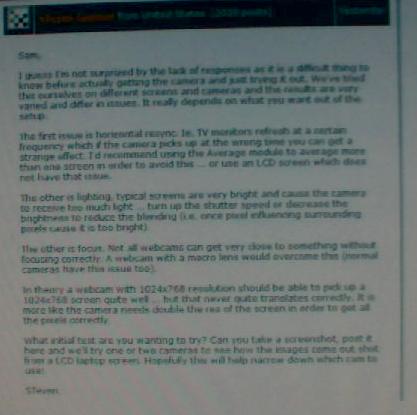

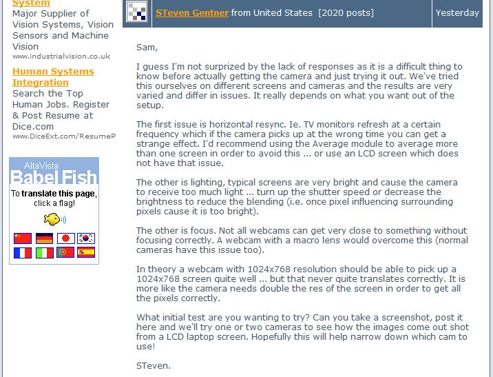

Attached is an example screen shot of a portion of this email as an example of the characters, objects and colors that must be seen clearly by a camera.
Hoping there's a camera that will do the job,
SamQ

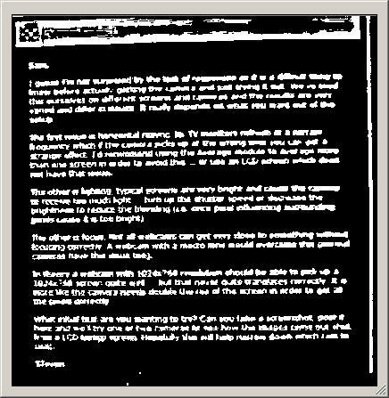

Just tried it with the quickcam pro 5000 and quickcam fusion which are reasonably good quality cameras.  I would say both results were pretty negative.  The images from the fusion are attached. (Cropped to relative text area at the resolution.)  Just some simple processing to normalize the histogram -> negative -> adaptive threshold.  I have a logitech 9000 floating around in the lab which is even higher resolution that I could try.

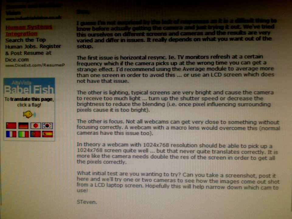

Yea, looks like a high res solution is really needed. The attached is the best I could come up with using a Logitech Quickcam for Notebooks. Looks like
http://www.amazon.com/Logitech-Portable-Webcam-QuickCam-Notebooks/dp/B000RZNI4S
Higher resolution is better and autofocus on near objects is a must. With a pan/tilt system this webcam may be capable of doing what you want.
Keep in mind that if RoboRealm can be installed on the computer then the Screen_Capture provides a much better result!
