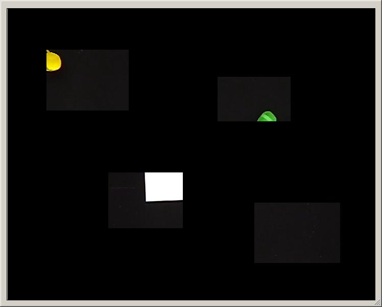

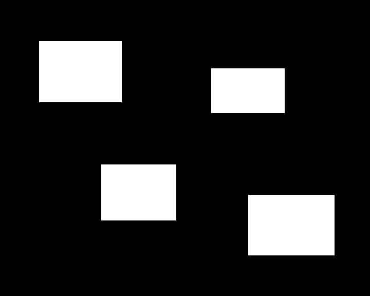

If I know that I always only need to analyze a certain region of the image, I create an black and white image with the same resolution and make the ROI (or multiple ROI) as white regions on a black background.  I then AND this image with the original image.  This is gives a nice and visual approach which is useful for prototyping.   If you are working with the API, the multiple crops is the way to go, but it gets really long in the interface.  (Gee code folding in the roborealm IDE?)
have fun!

My images are giving it hiccups!  (Mono bmp for the mask since jpeg can make white -> grey)
