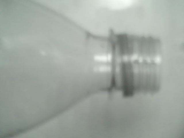

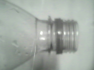

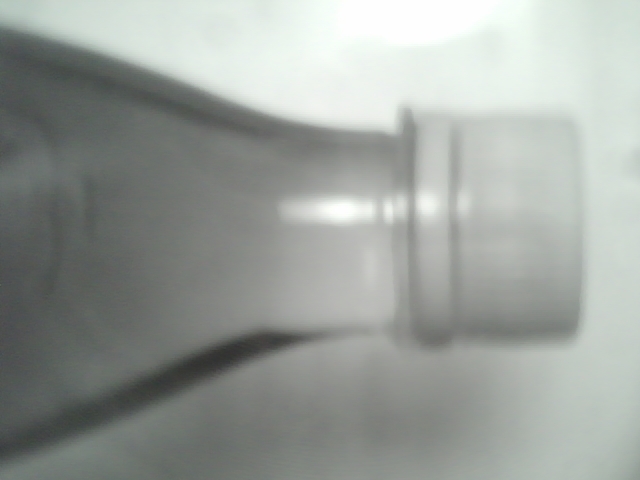

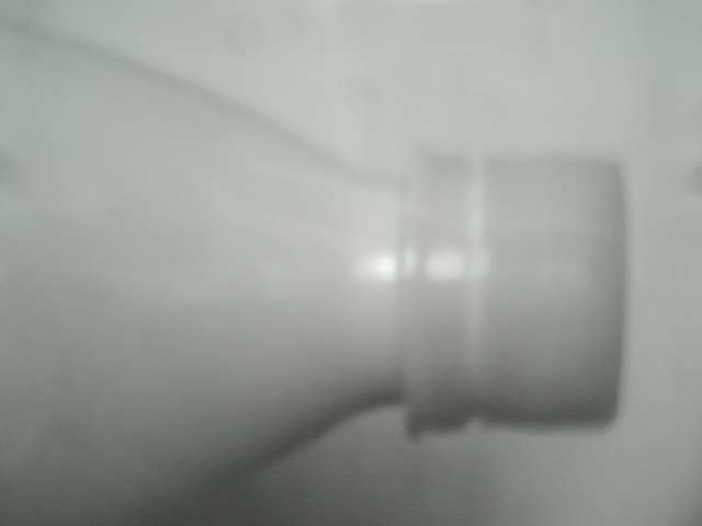

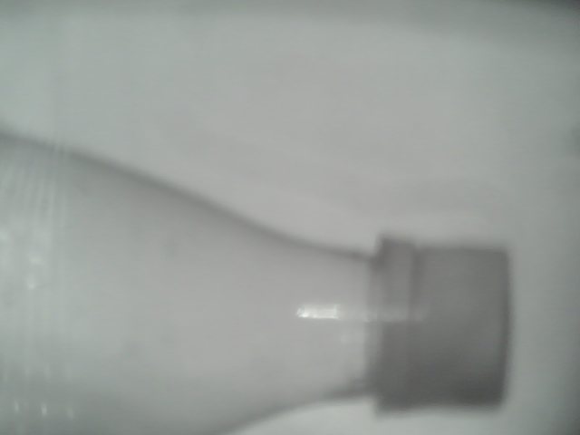

I just figured out that the bottles might actually be in different colors just as well as half-filled or empty so that will result in a solidly different images like f.ex attached pictures... Bottlse might as well have a stopper on top or or be without it...
Pavel,
I assume you have some control over the environment? Would it be possible to get some better pictures that are more in focus? You may need to use the macro setting on your webcam to get infocus images.
You may also try putting a different color background behind the bottles that are colored white to improve the contrast. Perhaps try a black, or green background. This may  allow segmenting the bottle top from the background to be a little easier.
