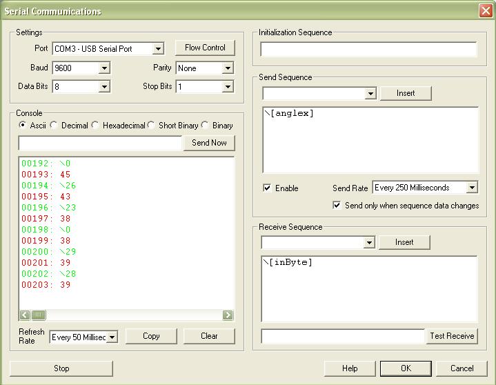

I dont understand how to put all incoming bytes into a variable...
In the documentation exemble I says thats the incoming byte is stored in the variables \1024:\667\n, but where is that specified ?
I just want tu put incoming bytes in a variable... But I don't manage to do that...
I tried to just write [inByte] in "receive sequence", but it doesn't work. (the variable is created in a VBScript)

The problem is that i receive data, but it dont go in the variable...

Thank for reply but look at that ! The variable is empty, but there is incoming bytes !

That seems right. Since you are requesting a byte you should be using
\[inbyte]

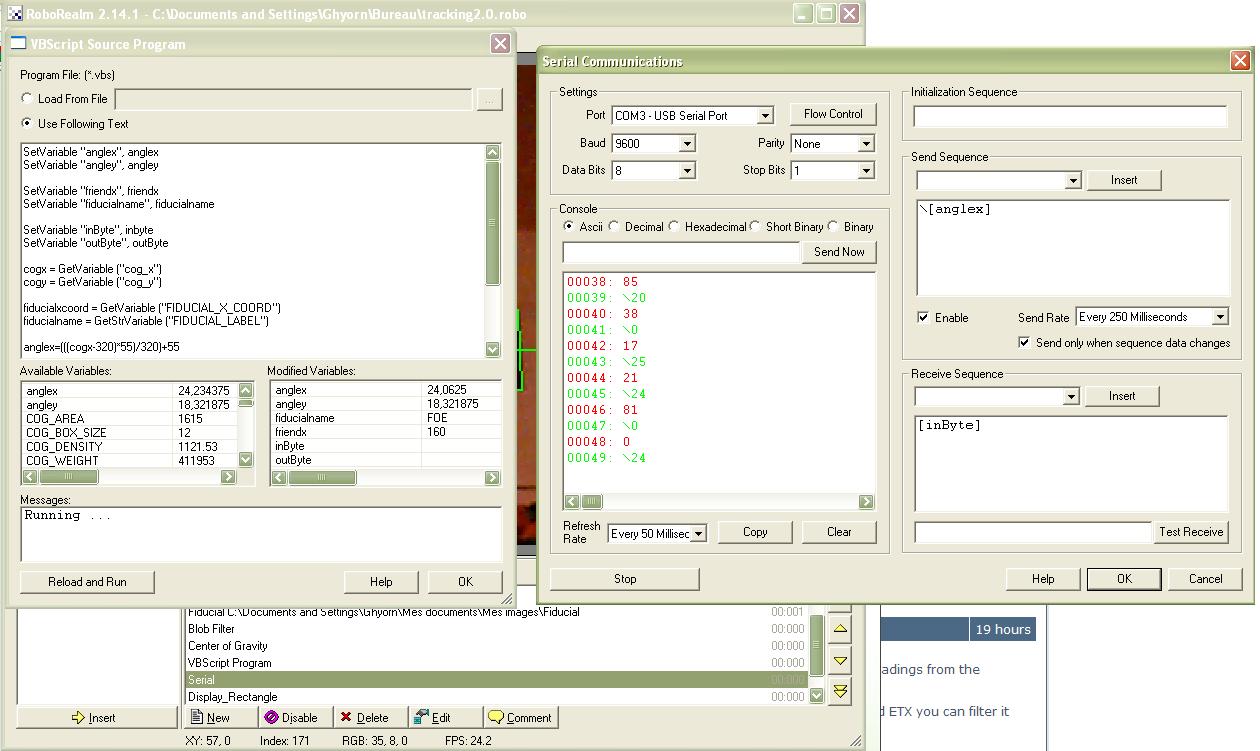

which will tell RR to read in a byte but the issue might be in your VBScript in that we see a SerVariable "inbyte", inbyte with inbyte not being initialized .. that would set it to "" (empty string). Try removing all modules except for the serial module and a watch variable module (placed after the serial module) and see if that byte appears or not.
If not, can you attach your robofile? Seems like there may be some inconsistencies elsewhere.

That's okay I did that but the inByte variable have his value just for a very very short time, maybe because the VBScript program initialize the variable each time the program does a cycle ? Then the variable doesnt appear in the VBScript programm, because of the too short time ?
Ghyorn from France  [6 posts] 8 months
Yeaaaaah it wooorks =)
.robo :
-Serial receiving [inByte]
-VBScript program :
   inByte = GetVariable ("inByte")
   ---program---
   SetVariable "inByte", inByte
Then I have a stable value of inByte to use it in the program !
Thanks you a lot =)
