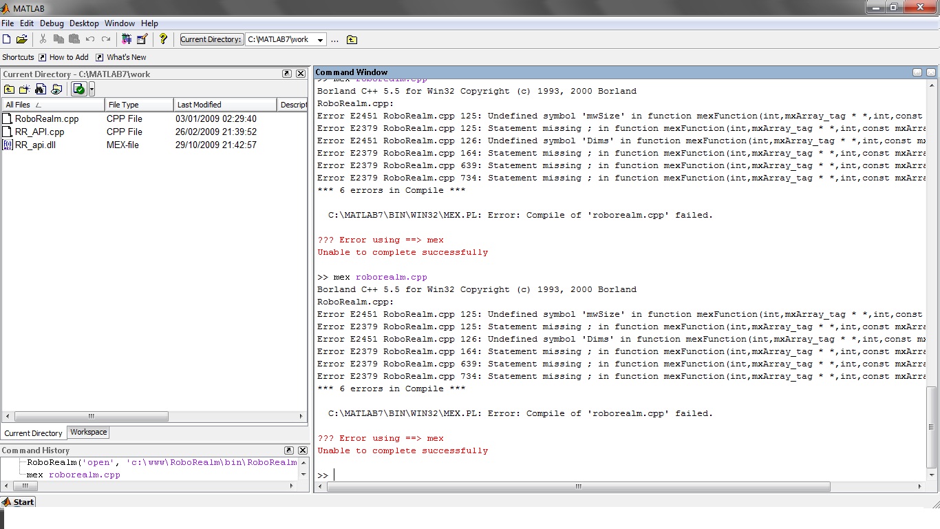

I`ve just followed the procedures to mex the Roborealm and matlab, but appeard some errors on the compile:
mex roborealm.cpp
Borland C++ 5.5 for Win32 Copyright (c) 1993, 2000 Borland
RoboRealm.cpp:
Error E2451 RoboRealm.cpp 125: Undefined symbol 'mwSize' in function mexFunction(int,mxArray_tag * *,int,const mxArray_tag * *)
Error E2379 RoboRealm.cpp 125: Statement missing ; in function mexFunction(int,mxArray_tag * *,int,const mxArray_tag * *)
Error E2451 RoboRealm.cpp 126: Undefined symbol 'Dims' in function mexFunction(int,mxArray_tag * *,int,const mxArray_tag * *)
Error E2379 RoboRealm.cpp 164: Statement missing ; in function mexFunction(int,mxArray_tag * *,int,const mxArray_tag * *)
Error E2379 RoboRealm.cpp 639: Statement missing ; in function mexFunction(int,mxArray_tag * *,int,const mxArray_tag * *)
Error E2379 RoboRealm.cpp 734: Statement missing ; in function mexFunction(int,mxArray_tag * *,int,const mxArray_tag * *)
*** 6 errors in Compile ***
  Somebody have any idea why is occuring that?
Seems like you are missing some include files along with Matlab.
You might try adding
#define mwSize int
at the top of the file. Note that you are using a really old version of Borland as the compiler so it may be an incompatibility there. Also note that we are not 100% sure that a mwSize is an int ... it appears to be but there was probably a reason that they used an alternative type ... but it is worth a try to see if that gets it to compile.
