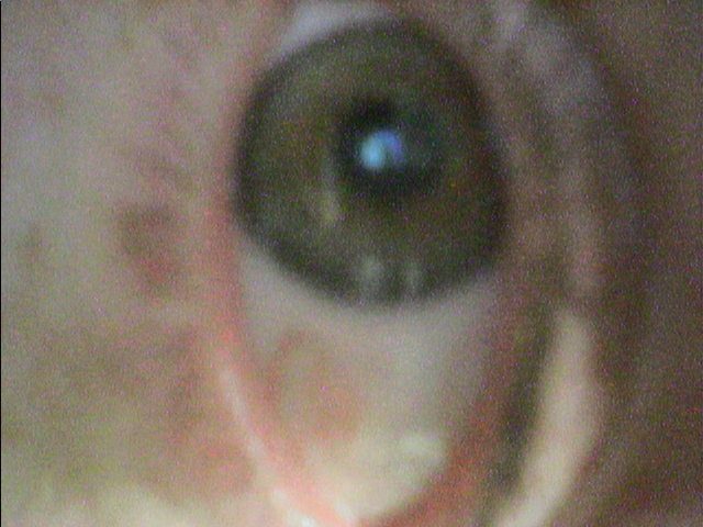

I would like to try and use roborealm to capture images of eyes and detect pupil size or use video and track pupil size changes.
Tim,
As it appears that the above photo is a little out of focus we had to scale it down to ensure that the edges are detected correctly. Attached is a robofile that will detect the pupil in the above image but at a much smaller size.
Next step is to see if this works with a video recording. If you have issues with that post  the video somewhere (like megaupload) and let us know.
