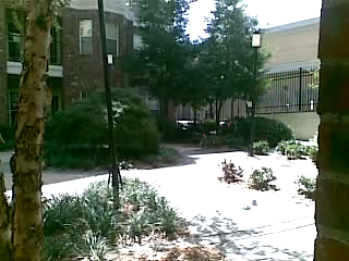

Rohit from United States  [4 posts] 17 year
This is the test video I am working on.
Video050.zip
This video contains a subject that moves into the frame, drops an object & then leaves the frame.
I need to develop a pipeline that could detect this particular addition of object & draw a square around it.  Any help ?
Rohit,
Thanks for the video! Attached is a robofile that does the job in this video. You will have to adjust the path of the first module that loads the background image.
Basically it determines the difference between the background frame and the current frame. It then uses the flicker module to determine stable objects and replaces them with a square object ... right now we set it to fill just to make the results more visible.
Note that this works mainly because the bag is much darker than the ground it is left on. More serious tests would involve objects of similar intensity/color ... but we're not sure if that is part of your project.
