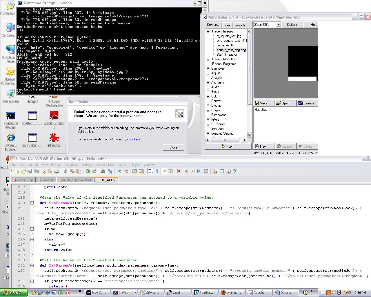

I’m trying to use the Python API.  I’m trying to get the test program in RR_API.py running.  The following is what happens:
1)    Edit RR_API test program to point to files on my system.
2)    Start the API server (6060, Time Out 0,1 or 3 seconds, Threads 1)
3)    Start Python and import RR_API
Result:
-    RR puts shows an error with a missing file name (the file is present)
-    After a couple of seconds Python returns an error from readMessage
If you click OK on the error pop up RR will crash (output is below along with RR_API edits).

Franklin  [23 posts] 17 year
Here is a screen image.
I updated to 2.5.7 but it still seems to fail.  Every command returns: "RuntimeError: socket connection broken".  Is there something simple I am doing wrong?

Franklin,
Yes, it does seem that something simple is going wrong. Ensure that the timeout of the API is set to 0 and then when running try telnettting to the port directly from a command prompt using
telnet localhost 6060
and see if it just exits or clears the screen in wait for some input.
The errors above just seem that no connection can be made ... are you sure you firewall settings are allowing for this connection?
I made sure the timeout was set to zero and turned off the anti-virus stuff.  It seems to work now.
-Franklin
