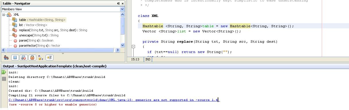

Maybe it is not a Roborealm problem, but I really need some help.
I use netbean 6.1 to run the project.
After I added three classes I downloaded from RR, it said that generics of XML.class are not supported in source 1.4.
Actually I have changed  java source level  to be JDK 1.5 in project properties, but it still cannot work and report the same error information.
Have you tried just removing the <String, String> and <String> from those declarations? Earlier versions of Java do not support generics either so give that a try ...
