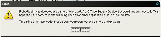

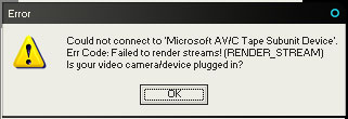

I have a Canon HV 30 HD Camcorder. I'm using windows xp with all the latest updates and service pack. The camcorder captures perfectly in Adobe Premiere, and HDVSplit etc. But when I start using RR it neither recognizes the device when selecting from the two possible items from the camera combobox Microsoft VDM Image Capture or  AV/C Tape subunit device. The camera connects thru firewire, and no other application is running when using RR.
any help would be highly appreciated, thanks

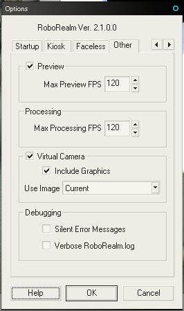

Aron,
Try decreasing the 120 preview and max processing fps to 30 fps and then test. It is possible that the system cannot handle that fast a frame rate when using HDV mode.
Also see if the Firewire module provides any better connection to the camera.
http://www.roborealm.com/help/Firewire_Camera.php
The error you are getting is from the Win32 DirectX subsystem that basically says that the current default configuration is not valid for that camera ... most likely this is due to the increased fps speed that works find in the DV mode.
