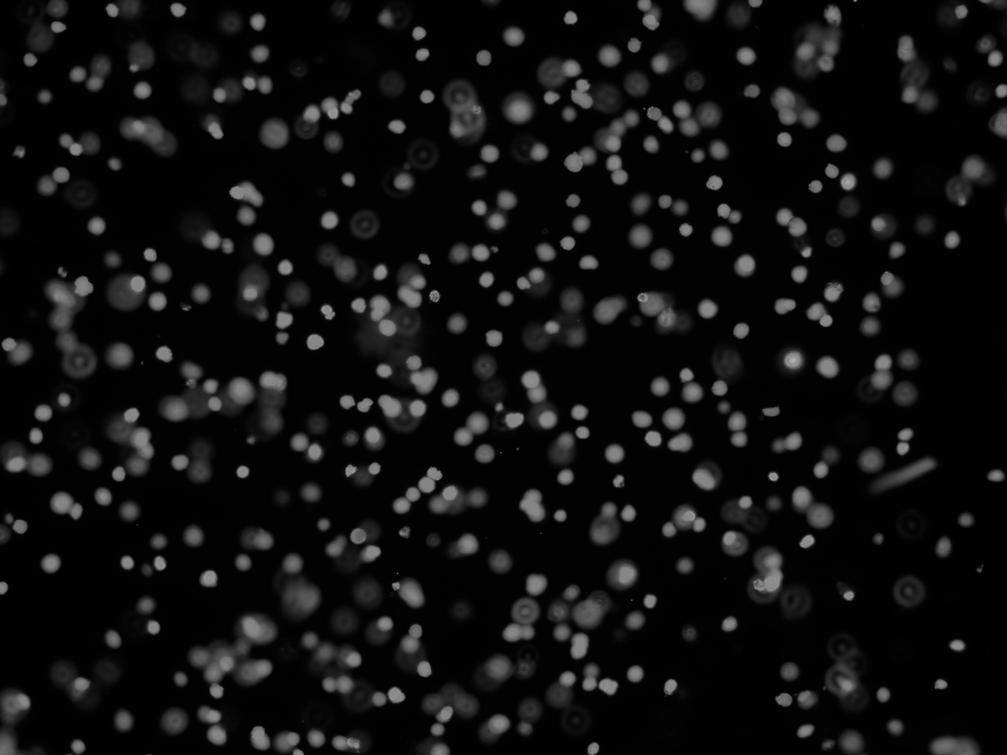

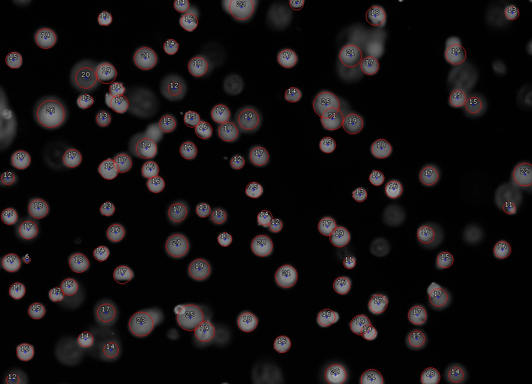

I am looking for a way to count the number and size of paint drops in a picture. I have already triad out a few things and in the pictures you can see some results. Not all the drops get measured and there are a couple that get measured that aren't even there, but whit a few adjustments and just using parts of the picture I think I can solve the those problems.

i have done a lot more work on this and I just have 1 problem.
As you may know when you use Circles to you get a integer array whit all the info about every circle. All I need to do now is to isolate the diameter of every circle and put it in an other array so I can load it in excel.
I think this must be really easy to but I cant figure it out, can someone help please?
for some inspiration I include a image of 109 drops measured
