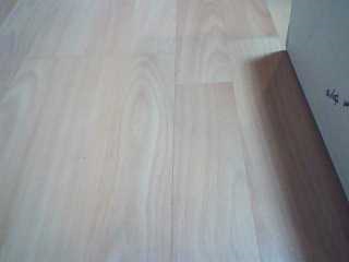

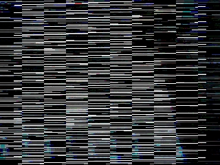

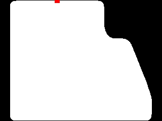

It appears that the spykee camera implementation is not playing nicely with other cameras on the system.  I can shut off my integrated webcam on the eee PC I am using by clicking on the camera button and things work fine.  However whenever I try to do any image math I get garbage.  The following three images show original, processed and then the results of image math (any image math seems to do this)
It looks to me like the image is a composite of the integrated webcam and the spykee output with some sync problem.
I am using the obstace avoidance tutorial edges.robo file.
The easy work around is just not to do any image math.  I think I will have to order another spykee to tear apart and remount the camera in the base.  This is a great piece of hardware!
Thanks for the great module.
Anonymous from United Kingdom  [99 posts] 18 year
After more work, i think the problem is a resizing issue.  Since the dimension of the images from the webcam and the spykee camera are different, we get the zig zag image?  It still shouldn't be using the webcam since it is turned when I am doing the image math but at least I think I have some idea what is going on?
Ok, the solution to the problem is to force the format of the spykees camera to the same resolution as the webcam.  This done with the SCALE function.  The Spykee's camera default resolution is 320x200.  You need to scale this up to 320x240 and then set your built in camera to this resolution.
