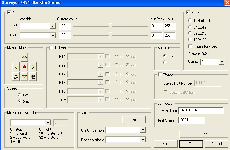

I gave things a few days and got back to this today.  Rebooted the computer and the SRV-1.  I'm using 1.8.23.31 of RR.  Added the SRV-1b module (pic attached).  Video works.  When I drag the motor sliders either left or right of center (128), the motors only run forward.  When I use the manual movement arrow keys, motors spin in the correct direction depending on the button pressed.  Any help is appreciated.  This issue prevents me from using variables to control the motors.  Thanks,

Win,
We have the same issue. It appears to be an problem in the SRV firmware that you have (we have the same version). Surveyor has also been made aware of the issue and created a fix. The new firmware should be available in a week or so. Updating to that version should fix the issue that you are having. We will also be doing the same ...
