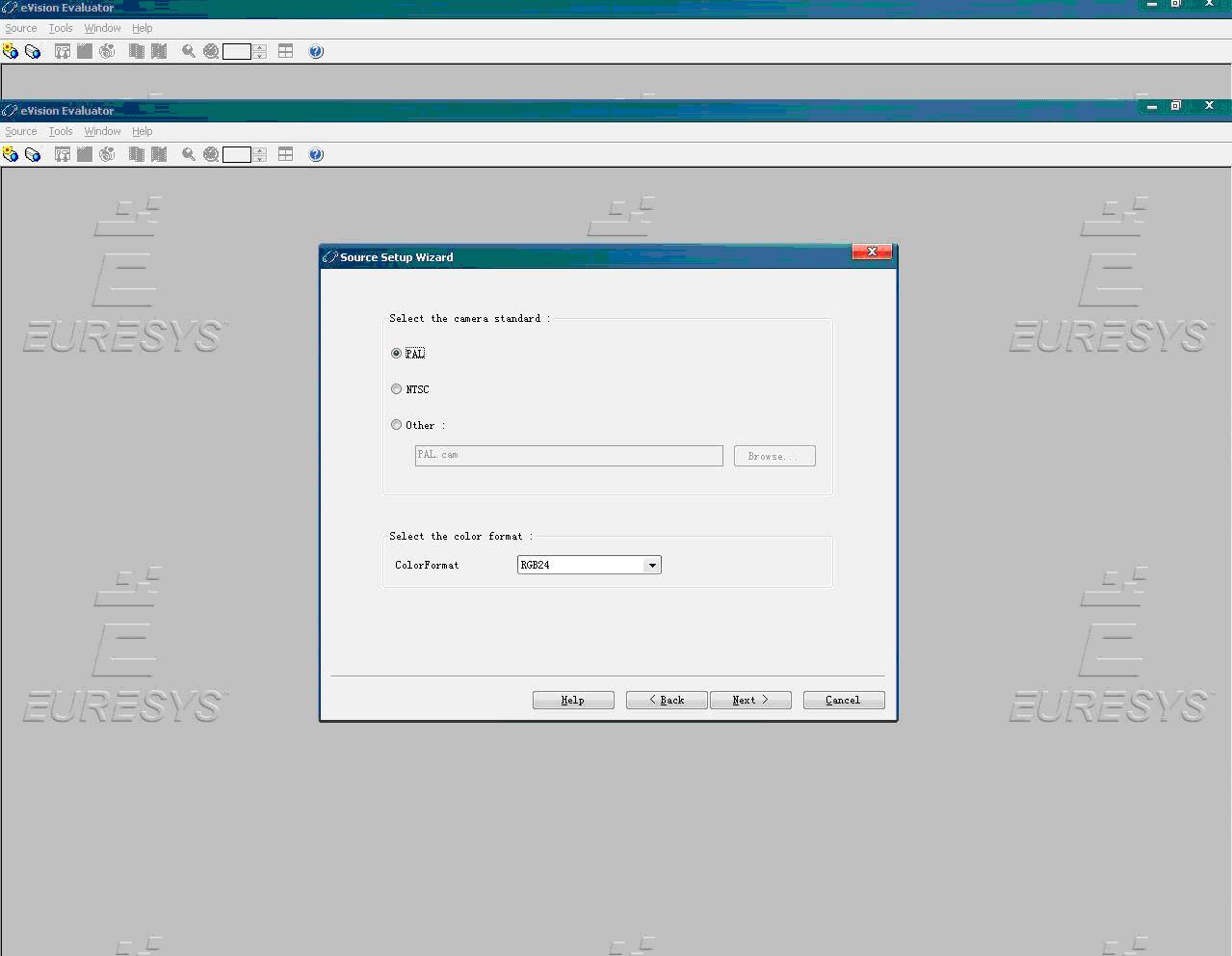

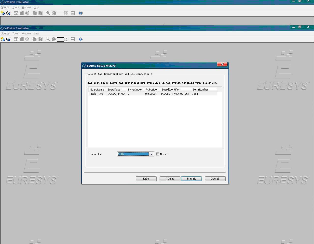

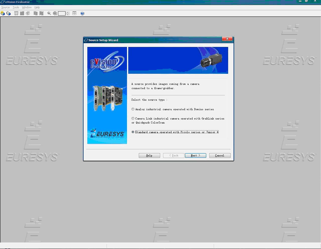

Hi, I just got a new camera which only supports NTSC format. My camera capture card can support NTSC and PAL.I use my old camera(which supports PAL format) and the camera capture card. I can get image, but with the card and the new camera, I can't get image in RR. Besides, I can't get image in Amcap. I guess RR could capture image in NTSC mode, I just don’t know how to do it. I really need your help as the new camera costs so much. I'm afraid I can't afford another one.

and my camera card is evision Picolo series card.

    Thank you for your reply.  I have a question, using Picolo capture card and my old camrea, I can get image. It means the card can support PAL format with DirectShow/DirectX drivers , just can't support NTSC format. If I should contact the card producer to ask  DirectShow/DirectX drivers for NTSC format.
