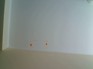

I have 2 ping pong balls (color orange) as you can see in the photo.
I am trying to establish the center of gravity to the bigger one or to the closer one, by using Blob Filter module.
Can anyone HELP ME !!!!!!!
I would be glad for any sample !!!!

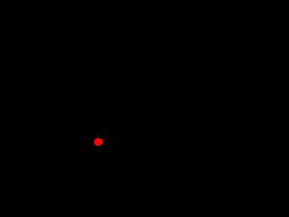

Sure, see the attached below.
Note that we had some issue with the blobFilter in the last week. Be sure to download the latest copy which should resolve those issues ... but I'm not sure if they apply in your case.
