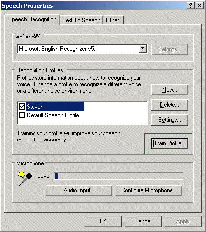

You should notice an icon like
next to your computer date/time. Click on that icon, select Options and then either create or use an existing profile. The GUI should look like
Click on the train profile and begin reading away (you get a couple selections of text to read).
