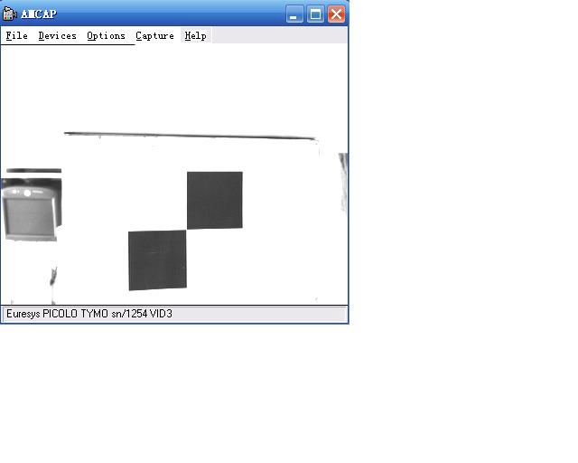

    My camera Euresys PICOLO Tymo can get right image from AMCAP, which is in directxsdk. but get a distort image in RoboReal. I woner how could i handle it.

   The image is right now,I still don't know where goes wrong,Euresys PICOLO Tymo is a camera cpature card. I connect the card
with a different camera, then connect the camera which is skewed again, the image is corrected.Besides,Options button->Video Tab->Video Format button
is disabled.

     the Options button->Video Tab->Video Source button is also disabled.but anyway the image is right now.but I can't change the stream format and fps.
I use "watch variabe" to get fps about 25,it's right with my capture card.it's stand
pal, frequency is 40ms.
