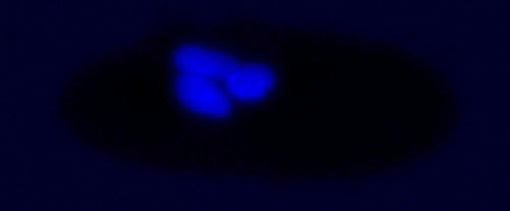

PS: There is a sample image of the dapi staining attached. These are examples where it is hard to train a program how to separate adjacent cells.

Also, how many cells should the count be in the images? 3 in both? Or does the first one only count as 2?
